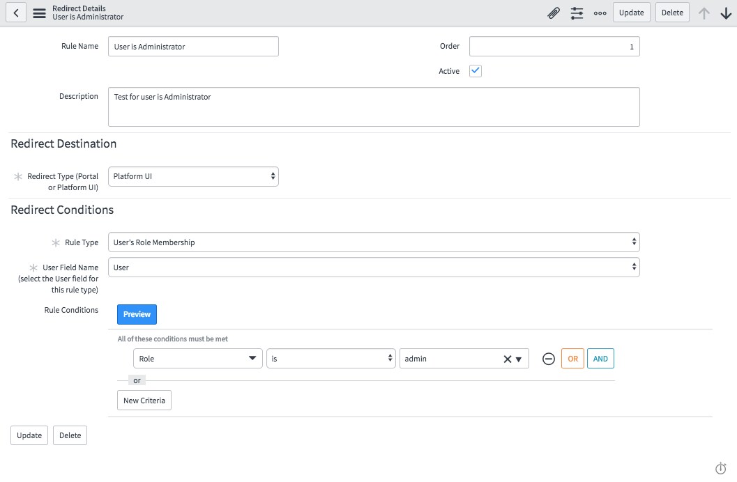

I'm working on a solution for this myself - I'm trying to built a Scoped App that will replace the SPEntryPage script along with a reference table containing a sequence of rules to redirect if a user's Session matches.

As promised yesterday, hot off the press here's my Service Portal Redirector App on Github:  https://github.com/milligna/sn-portal-redirector.git
And here the quick and dirty Wiki for how to use it:
https://github.com/milligna/sn-portal-redirector/wiki/Welcome-to-my-ServiceNow-Portal-Redirector
It basically replaces the SPEntryPage script and lets you create a series of rules for different user attributes: Groups, Roles, Field values, and tells the Redirect Script whether or not to send the user to the Platform UI or to direct them to a specific Service Portal:
It's in testing in my environment now, but it seems to do the trick.  I thought I'd do it as a scoped app and see if it works for others.
The only limitation is that Scoped Apps can't access some of the functions required by the SPEntryPage Script include, so you have to create your own version of SPEntryPage in the Global Scope to use it.  The sample Script Include in the Scoped app won't work while it's scoped, but if the content is copied out, then it will.
