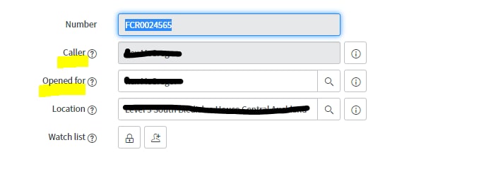

I created a Flow Design to send out approval email reminders every 7, 14, 30 days etc.  The reminder notifications (using sysApproval table) to the Approver is being sent and is working fine. However, I also need to send the same email to the Caller/Opened for of the Request, this part is not working.  I added a script to the Flow as follows:
The Request to fetch the Caller or Opened for name from the Request ie:
I also tried this, which does not work either:
