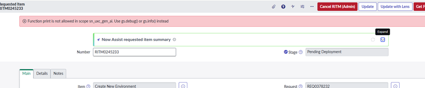

After upgrading the Now Assist for IT Service Management(ITSM) to the latest version (13.0.10 when this post was written) we started to get this error message on every RITM and Catalog task forms
Function print is not allowed in scope sn_uxc_gen_ai. Use gs.debug() or gs.info() instead
I've cheked all business rules, script includes related to this table and haven't found anything... please help
04-24-2026 05:57 AM
Issue has been fixed, we upgraded to 13.0.11 and message is gone. So basically it was just outdated plugin.

Yeah it appears that something went with the plug in patch, we haven't done any code on Request tables I tried your suggestion and the majority of the code is OOTB, we def will reach out to Servicenow thanks for your help.

04-24-2026 05:57 AM
