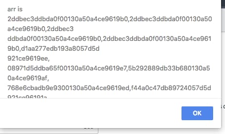

hoping you can help with what I'm trying to do...I've got a list collector type field on a catalog item, and I have a GlideAjax set up to return the groups of a certain type that the user (as determined by a reference field on the form) is NOT in.  I want only these options to visible for selecting in the list collector type field.  Thanks in advance Chuck!

what can I put here so that the choices for the field 'u_list_groups' are only what is returned in "arr"?
And I know my array is coming back correct because of my alert message
