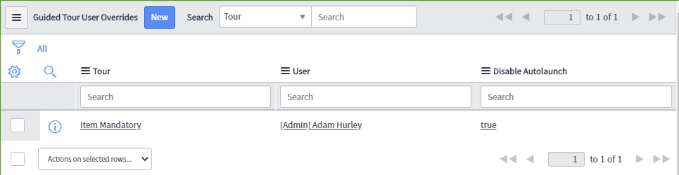

I plan to write an entry to "sys_guided_tour_user_overrides" if the user views or dismisses the tour. For now, I have manually added the entry in the table to test whether I can read from the table:
