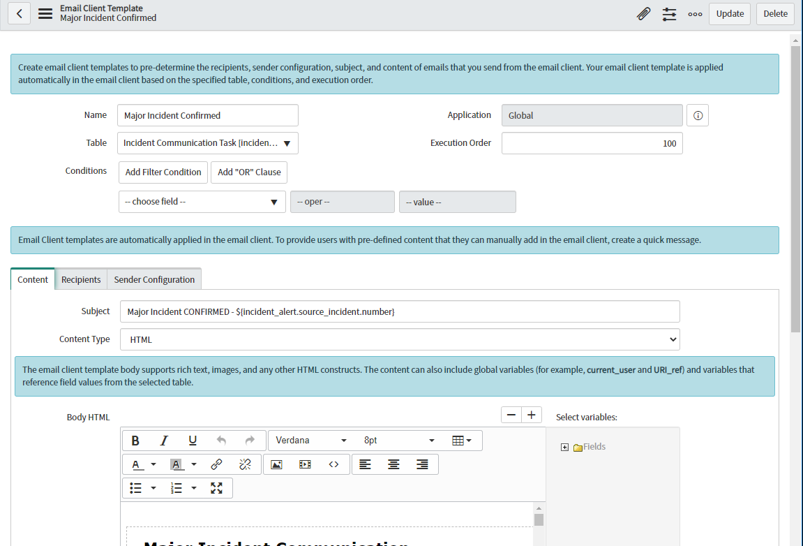

We are preparing for Major Incident Workbench roll out.  We have Email Client Templates configured.  There is an option called 'Sender Configuration'.  It's not clear how I could set this up for the sender to look like:
IT Major Incident <ourcompany@service-now.com>
just for Major Incidents.  In other words, I just want to modify the display name.
blairf
Giga Expert
I submitted a case to support, and they provided excellent instructions (pasted below).  Basically it needs an entry in 'Email Client From Address'.  Then in each 'Email Client Template', update Sender Configuration to have:
Select From List
then choose the new entry in Email Client From Address
From support:
First to show the From field on the Email client you need to turn on "Display From" here:
https://yourcompany.service-now.com/sys_email_client_configuration_list.do?sysparm_query=&sysparm_view=
Then I created an entry in From list here with label and email address:
https://yourcompany.service-now.com/sys_email_client_from_address_list.do?sysparm_query=&sysparm_view=
Then in the template: "Major Incident Confirmed"
https://yourcompany.service-now.com/nav_to.do?uri=sys_email_client_template.do?sys_id=52d3eff5db194410695ed6fa4b96191f
Under Sender Configuration I chose "Select from List" and I chose the one I created above.
