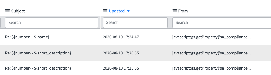

In the Client template, there is a From field, which mayn't be visible, but you can add it from the list view. You can use that to set the from field/sender.
Below is an example
Thanks, the 'From' field is available when 'From Generation Type' = Text.  I have tried using it, but I don't see a difference in the outgoing email.
What do you see in the email queue in ServiceNow. Because outlook may reset it back to its original name.
