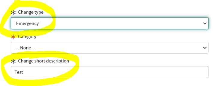

Here firstly I selected change type as Normal and gave the Short Description as Test and again I changed the Change type Value to Emergency but the value of Short Description not changed so how can i give the exact condition to clear the value and also similar to all other variables present in form.. Please help me with this

01-05-2022 12:09 AM
Easier with Client Script.
return;
if (oldValue != newValue) {
g_form.setValue('<fieldname>', ''); // have this for all the fields

are you using client script or UI policy for this?
01-04-2022 11:44 PM
Hi
Thanks for the Reply!
Tried with UI policy like if Change Type is one of Normal, Emergency then clear the values but its not working...
01-05-2022 12:15 AM
you can handle using client script easily.
I will suggest to start on it and if stuck members can help
01-05-2022 12:09 AM
return;
