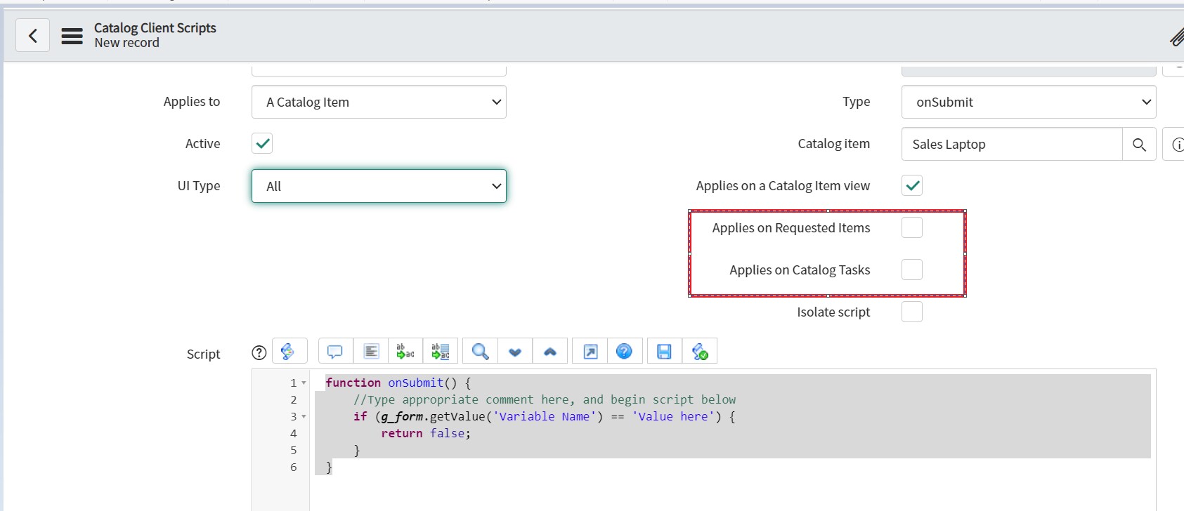

How can we disable SUBMIT button on Service portal and ITIL view when we select particular value on catalog variable on a catalog item
02-21-2022 04:31 AM
How can we disable submit button on Service Portal view as well as ITIL view when we select Particular value under catalog variable on the catalog form

getReference with callback might not work as by the time the callback method is invoked the submission might happen
why not make the script run onChange of that select_group variable and show and clear the message and make it mandatory so that it allows submission only when value is valid
