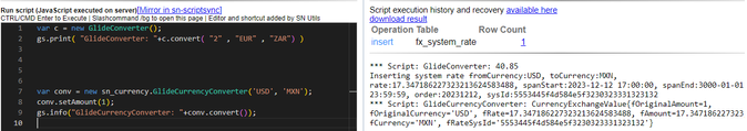

Hi all, I'm trying to understand how fx_system_rate records are updated o inserted. Basically, I am trying to make a currency convertion between some currencies (USD,EUR, etc) to MXN.
I'm using  GlideConverter class to make this convertion, here's and example:
I noticed that call that API creates a record on that table, but ¿where is the initial rate stored in servicenow?
I tried to look for that value in fx_rate table: but the latest value value does not match with the value used for GlideCurrencyConverter or GlideConverter :
