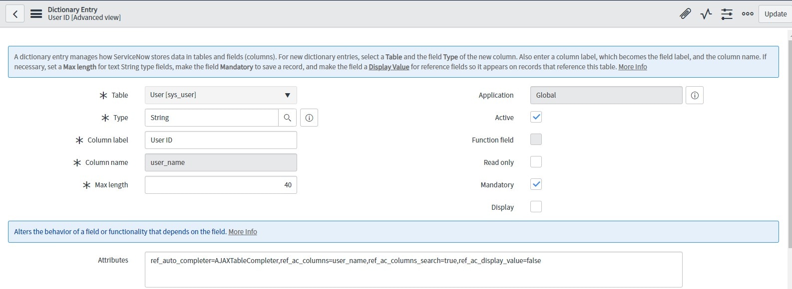

Hello everyone, a pleasre to meet you all. On the reference field when use the user_name to search a user appears first the values of the column name of the sys_user's table.
So, when choose that user, it sets on the name and not the user_name that is what is required to show on the field.
Then I try to edit the Variable Attributes of that reference field and put the following value .
ref_auto_completer=AJAXTableCompleter,ref_ac_columns=user_name,ref_ac_columns_search=true,ref_ac_display_value=false
On the ref_ac_columns put the column that only want to show and put the ref_ac_display_value on false to hide the display value, but I think it doesn't work on Service Catalog.
Also, edit the attributes of the column user_name and put the same value as above.
But, it didn't work.
Thanks in advance
Claudio

10-01-2020 03:14 PM
To show value of User ID (aka user_name) instead of name, set "Display" of user_name to true in the Dictionary Entries on sys_user table.
- In Application Navigator, enter "sys_user.list" to display user table.
- Right click on the header and choose "Configure" > "Dictionary"
- Search "Column name" equal to "user_name"
- Set Display to "true"
