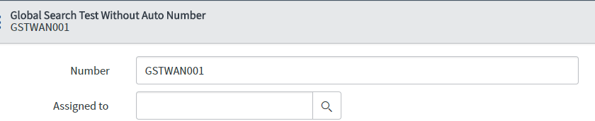

Hi Wirasat,
You can try with field style; its working for me. See the screenshot below
For this you need to configure style against this field in field style
Type Field style in application navigator; configure against your table-field.  Let me know if it still does not work and if it works mark this as helpful.
e.g. like this.
