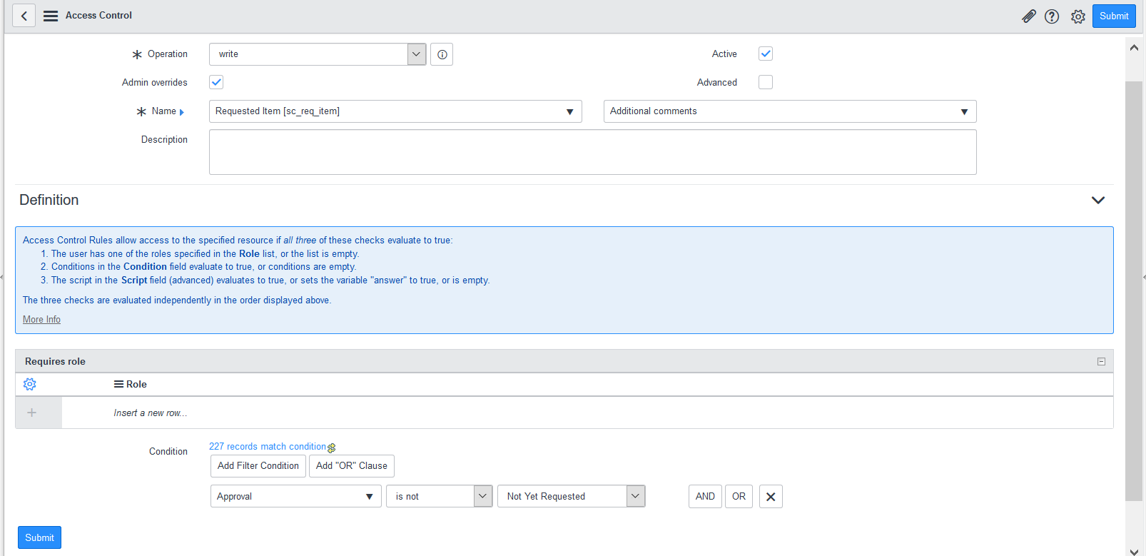

Hi Meenal,
you can write ACL on that field with condition as approval is not Not yet requested
Can you share the ACLs or ui policy you created?
screenshot of acl created by me; try creating that and let me know

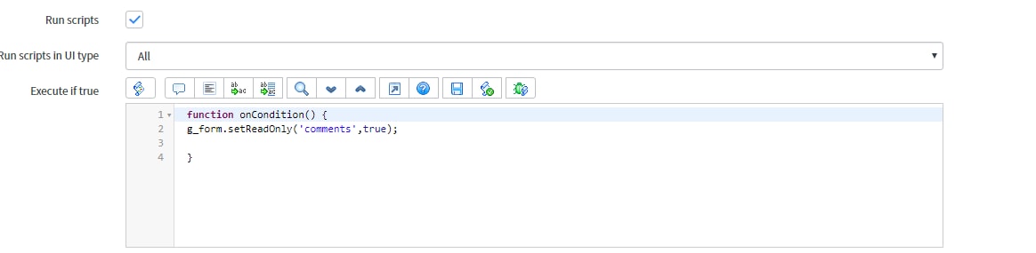

why you have not written UI policy action and used script; any reason here?
09-26-2019 08:43 AM
Hi Ankur,
I wanted to check if script is working on Portal or not.
Actually UI policy is hiding the field according to condition on ITIL View But this is not working on portal view
