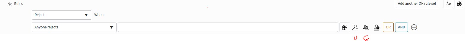

Unfortunately I haven't, the best I could do is to chain Ask for Approval actions where all but the last approval in the chain has it's approval rule set to reject when anyone rejects and the last approval is set to approve or reject when anyone rejects.
This still causes the Approval field to jump back and forth between Not Yet Requested and Requested but at the end of the day it works to create the approval chain. Just be careful that you don't have any logic running on the Approval field that is triggered when the value changes to Requested, otherwise that will trigger for each new approval that is generated.

I tried this, and what kept happening for me is:
If the first approval is APPROVED, the second approval was sent to the group of users as expected, but the first approval was reset back to "requesting approval". The first user can approve again and bypass the second tier of approvals. Looks like this after the first approval was already approved:
