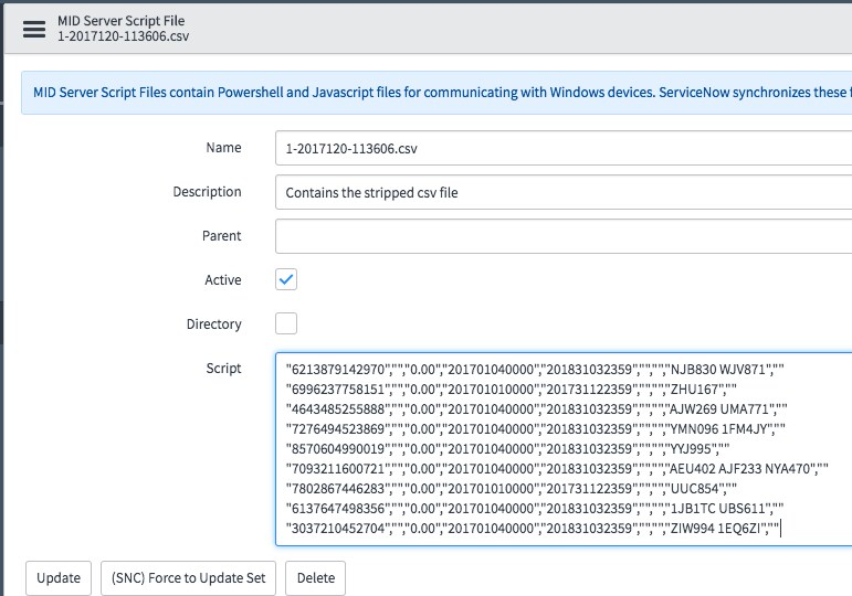

Here is what the MID Server script file looks like:
Mussie
Mussie
