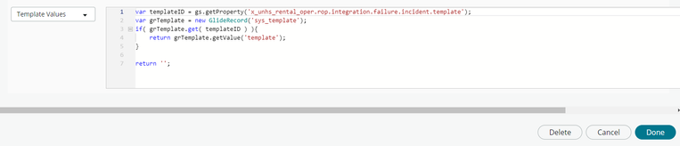

What I found out is that it works if you pass an encoded query.
For example, you can create your record template and create a variable in your flow/subflow, then query the template table to get your template record and get the encoded query stored on it.
Once you get that, you can simple drag and drop your variable in the spot "Drop in a template to define your field values"
That was the only way I could make it work.
But I noticed an issue, if you set the template in that way and you add more field values by using the "+Add field value" button then the template values are ignored and just the fields you're setting with this last option are set.
Hope this helps somehow.
