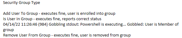

I'm having trouble with the 'Is User In Group' action when running against a Distribution Group type. Are there any specific or more granular permissions required to query a group of this type? Journey notes below. The issue with this not working correctly is that it won't run the removal if it reports back that the user is not in the group. We want this check in there so we are only running actions if they need to be.
Security Group Type
Add User To Group - executes fine, user is enrolled into group
Is User In Group - executes fine, reports correct status
04/14/22 11:26:46 (984) Gobbling stdout: Powershell is executing... Gobbled: User is Member of group
Remove User From Group - executes fine, user is removed from group
