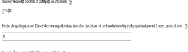

for test count of view :
If you have rights, simply type "kb_use.list" in the navigator filter. It shows how much user viewed that knowledge in mention days. refer fig.
Number of days (integer, default 30) used when summing article views. Views older than this are not considered when sorting articles based on view count. 0 means consider all views
(glide.knowman.view_age.days):- we make change here days 90 to 120
Navigate : knowledge>>properties>>
Enter a number of days to consider when calculating view count. This is used only when the Knowledge section sort field property is set to View count. The view_count field in the knowledge record will be updated periodically to reflect the view count based on this property. For example, if you enter 60, the view count is the total number of views in the past 60 days. Enter 0 to have ServiceNow consider all views, regardless of date.
