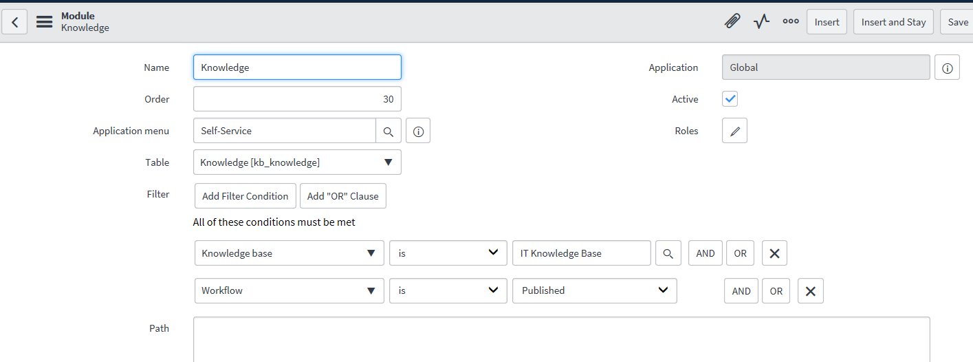

I found the answer to this question. If you open the Knowledge Module (in System Mobile UI), you can add the Knowledge [kb_knowledge] table and then put in the conditions for which knowledge base. Like this:
Worked like a charm.
