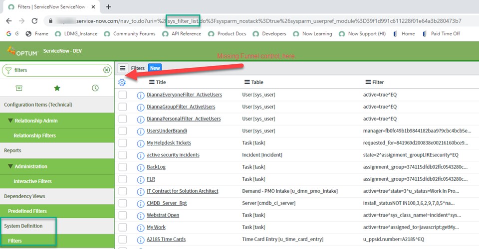

I can see and manage hundreds of thousands of filters. Luckily, because there are so many in the list view, I of course have the ability to Filter the Filters.  (I know, it's a little bit confusing.  I'm looking at filters, and I'm using the Funnel icon to filter those filters.)  The list view looks like this (note the funnel icon):find_real_file.png
But one of our power users, our CMDB Admin, does NOT have this ability.  Note the missing funnel icon:
I tried to use "Debug Security Rules" to locate some missing Role or some Rule which is causing this behavior.  Could it be one of these???

The ability to filter can also be controlled within "List Control", which in this case...for the sys_filter table, it is. It's limited to 'admin' only.
Please navigate to your sys_filter table list view, right-click any column header and choose "Configure > List Control" and then note the filter roles being applied. You can remove that role if necessary:
