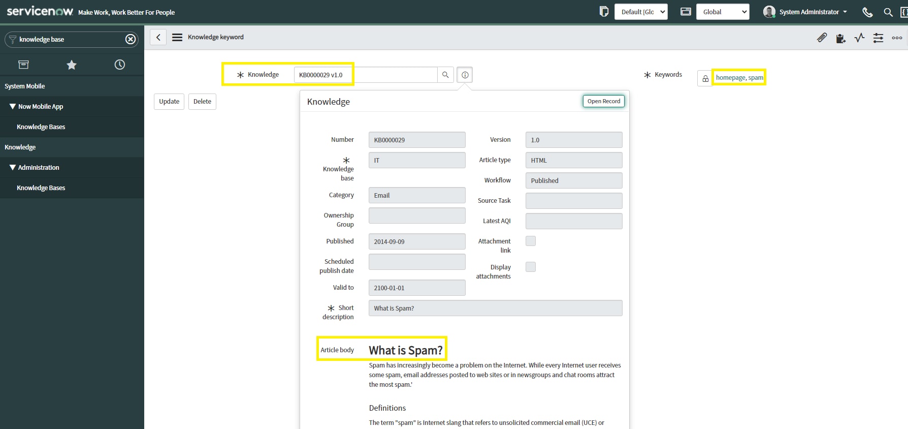

I've tried on my PDI, below the settings:
1) Added a new Knoweldge Keyword for the KB article "Spam":
2) Added the widget Knowledge Featured Articles in the kb_view2 page from the designer:
3) Result:
Hope this can help you!
