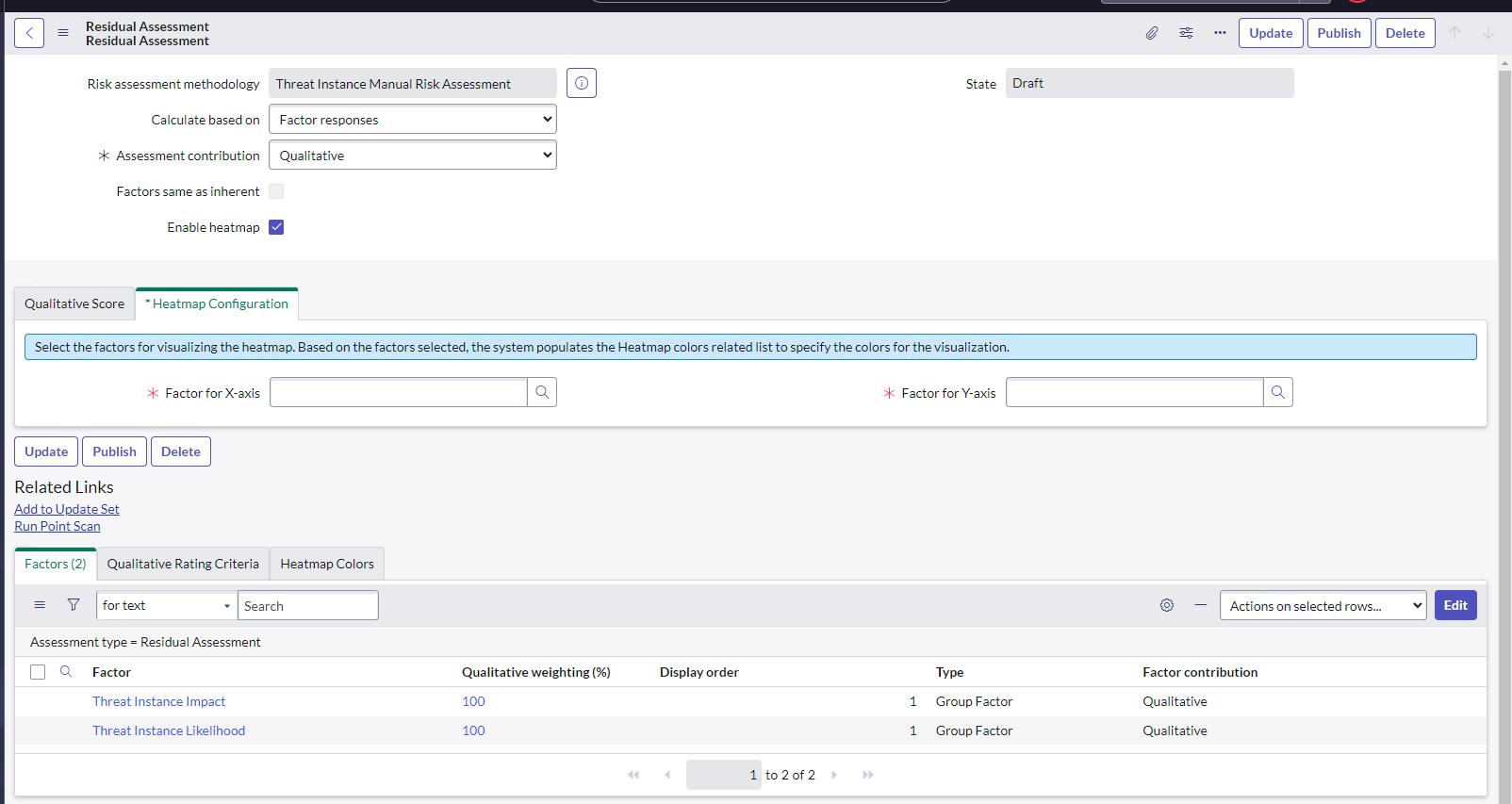

I am trying to set up a Risk Assessment Methodology and am struggling to populate the Factors for the X and Y axis of the Heatmap.
Set up is as follows:
If I open the 'Residual Assessment' Assessment Type, you can see 'Enable Heatmap' is ticked, but I am unable to populate the factors for the Heatmap:
I can't see how to populate them:
Any help would be much appreciated.
Tom
I am very late with this answer, but I was investigating the same issue now. There is a reference qualifier on the field, it leads to a script include RiskAdvancedHeatmapBase.
Long story short, in my case the issue was
    factor.addQuery('transform_score', 'true');
this part of the query. Once I set it to true, its working.
Also you might be facing an issue if your factor is quantitative, because of
  m2m.addQuery('sn_risk_advanced_factor.factor_contributionIN2,3');
few lines above the previous script I copied...
