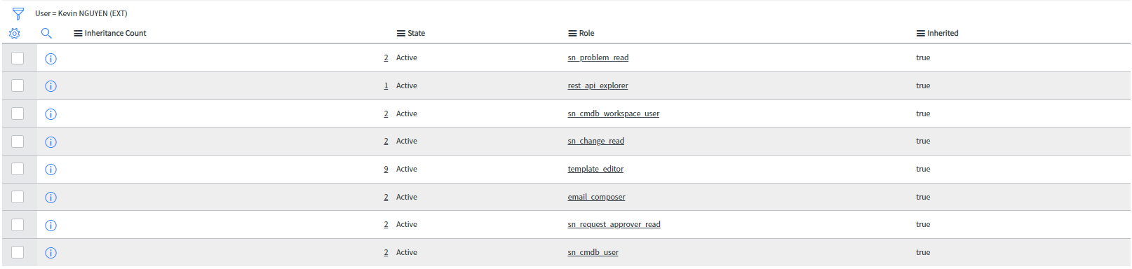

2. But when I used the code sample from UI (Python) and inputted to ATOM to run (already changed username and password), I received error code 401 although I had the necessary roles for my account.

Yes, user account has access to the tables (roles are mentioned in the attachments) and I'm using normal Windows machine to access ServiceNow, not via MID server.
