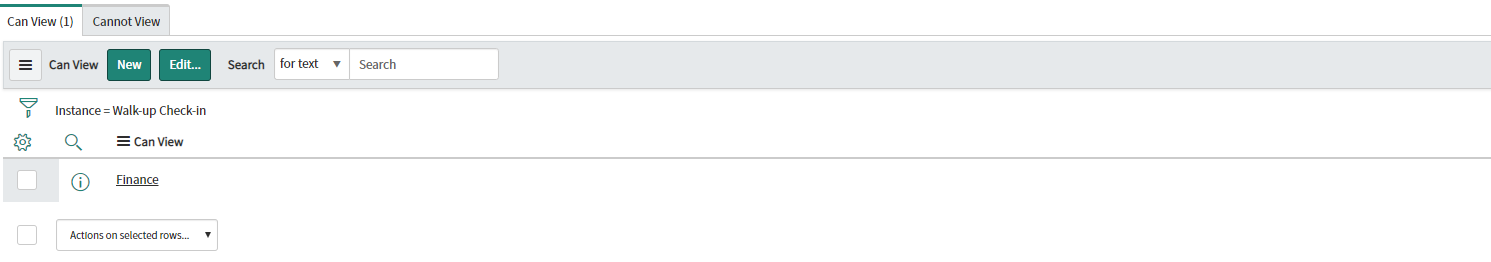

I have an icon link widget on the service portal for the walk-up experience. When I open in the platform option [SP instance config view] in the non-production instance, the below options appear.
I added the Finance criteria record to the can view option and removed any role. This worked when testing it in non-production and as far as I can remember, these were the only steps taken.

Hi Sam,
The related list won't appear if the User Criteria system property isn't enabled.
Set the value to true and the option will appear.
Here is the full name of the property:
glide.service_portal.user_criteria_enabled
