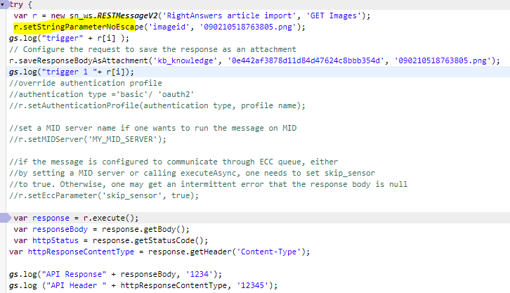

I am using below code to save the outbound REST (GET) calls response to save in attachment table but it's not working, the code is not getting executed even if I comment out highlighted line of code. this returns response when we do not try to save the response, what am I missing? I followed - link

please do not call response.getBody() after execution of REST message. You can load the response as an attachment or fetch the response body as text, but not both!
For a working example please see https://developer.servicenow.com/blog.do?p=/post/saving-restmessagev2-responses-as-attachments/
Maik

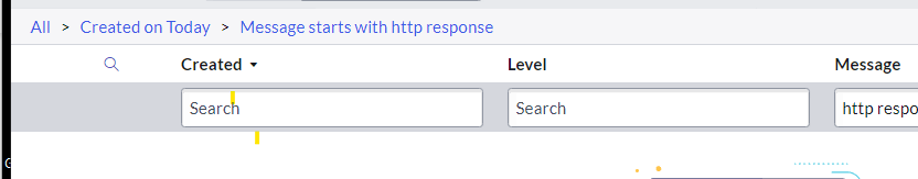

Hello @Maik Skoddow  thanks for your input, I removed that but still the attachment is not getting stored into sys_attachment table. we are able to values in logs when we execute without saveresponsebodyasattachment. please advise. find_real_file.pnglogs:

@Maik Skoddow  1. if we open the image in separate tab then we do see the image with it's absolute path which is from RightAnswers which we are accessing through reverse proxy, so no issue there.
2. I checked the HTTP outbound log table and I see that I am getting error that '[ERROR Code :200 ] unable to save response body as attachment: user not  authorized' though I have provided admin and knowledge admin role to the MID server user as we are trying to connect through MID server.
