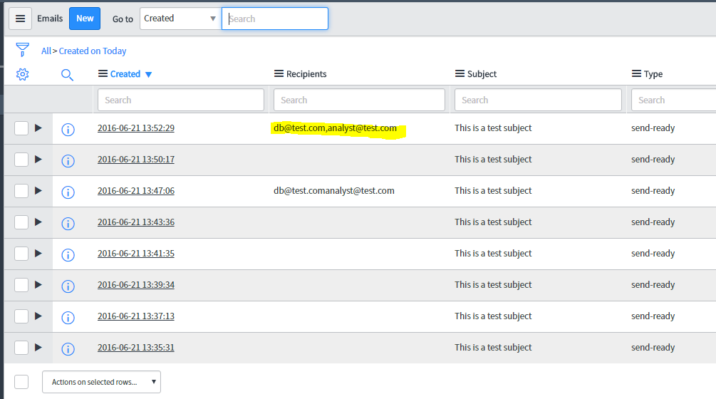

OK, I did it, but it isn't elegant.   I put a business rule on the email table that looked for a specific subject from the Scheduled Report (you can trigger it off anything, really):
Then had a script include:
And it did what I wanted.
My queries are simplistic, but it worked.   Just change the queries up to what you want to get the email addresses.

That definitely works as you describe, assuming that the groups' "Group email" attributes are populated.   It does not quite get all the way to where I need to go...but I think I can build off if it.   Thank you VERY MUCH!
The result I'm going for is to have the recipients list be all of the individual members' email addresses of the target groups, not just the "Group email" of the group.   I'll try to figure that one out.   Your response was very helpful!
