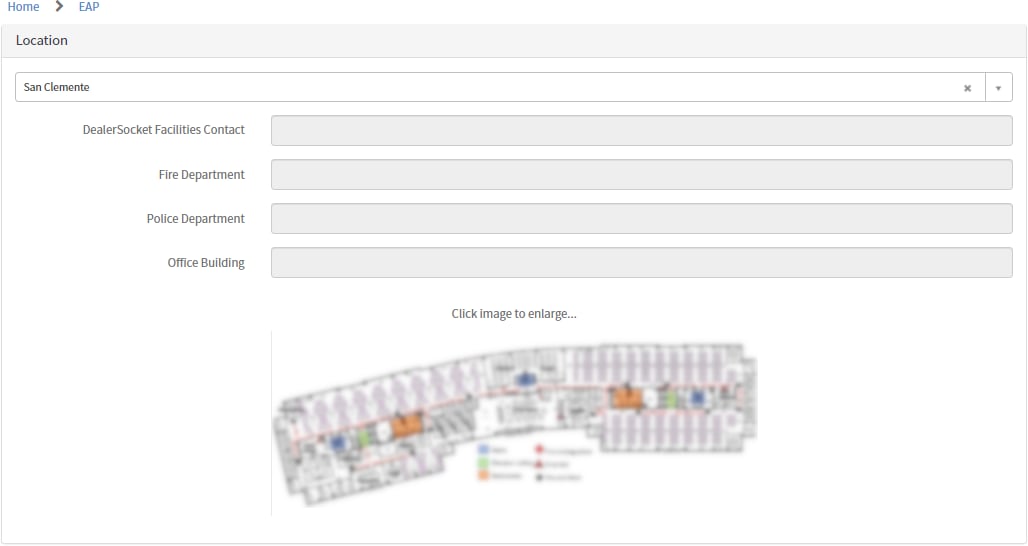

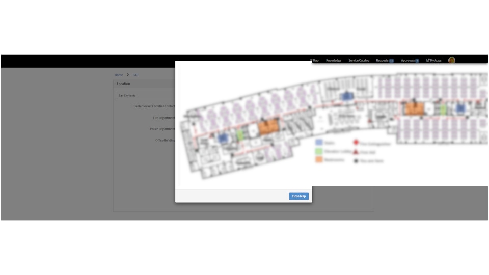

I'm trying to get an image to pop up in a modal/lightbox on the service portal, but I can't seem to get it to display correctly.  I'd like to use the width of the browser window, and not be limited by the narrow bootstrap container, as this is for displaying floor plan images and some of are hard to read when sized down to fit.  I have a thumbnail that on-click should pop a full-size image (or at least span the window).  Currently the modal remains narrow, but the image is left-justified to the modal and the right side breaks out of the window.  Clearly this is not ideal (see below).

Here's the HTML section I'm using for my thumbnail and the modal:
<div class="panel-body">
  <center>
    <p>
      Click image to enlarge...
    </p>
    <img src="{{data.loc.u_evac_map}}" width="50%" ng-click="c.openModal()" />
  </center>
</div>

And here is how it all displays in SP, both the thumbnail and resulting modal (images blurred to protect the innocent):
Any thoughts on how I can adjust this to be centered and full width?  I suppose I don't need the standard modal window background (is that "panel"?), but am not sure how to manipulate this, or if perhaps there's another solution altogether that I'm just not aware of.  Any input here would be great.
I'm not sure that I understand your problem correctly.
The first picture, which you post looks like some page and widget with
<img src="" width="50%" ng-click="c.openModal()" />
included in Body HTML Template of the widget. Is it so?
Now you want to display modal dialog with some content if user clicks on the image. The code could be about the following
spModal.open({
	title: "It's öarge image",
	message: "<img src='https://...' style='max-width:1370px' />",
	buttons: [{
		label:  "Click here to close",
		primary: true
(you can use $uibModal if you like it more, but spModal is just a wrapper to $uibModal)
The parameter size: "lg" means that created modal will contains classes "modal-dialog modal-lg" (with "lg"). There are exist CSS rule
.modal-lg {
    width: 900px;
 in Bootstrap CSS. If you need to use another width width you can use any other string value for the size parameter, for example size: "custom". As the result the dialog will be created with the classes "modal-dialog modal-custom". So you will need just add CSS rule
.modal-custom {
    width: 1400px;
on the page, where you use the widget or on the theme of portal (not in CSS of the widget, because modal will be appended to body and not to the div of the widget):
After that the popup dialog will have width 1400px.

Hi Oleg,
Thanks for your response.  You are correct about my intent with the HTML section.
I had tried some of what you proposed, but the piece that seemed to make the big difference was setting the CSS within the page and not the widget itself.
Thanks for getting me on the right track!
