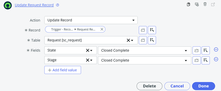

Hello @aditi__patil
You can update the record using the Update Record action once the request is approved.
Refer to the screenshot for details.
Note: Ensure that you modify the field values as per your instance configuration.
Hope this helps!

Hello @aditi__patil
Hope this helps!
