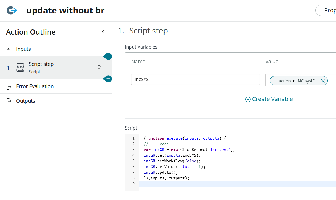

Hi.
I did some experimentation, just for the fun of it, and there is a way around.
I can't say that I would recommend going down this way, a better way might be considering to change the conditions on when your business rules run, if that is possible.
That being said, a way to work around the business rules is to create a custom script action in the Flow, and call it to change the values as needed, and in the script insert the same old gr.setWorkflow(false); as you would in any script.
Example below.
06-22-2022 12:43 PM
HI Olan,
I have tried this and still its not working.
Scenario: I need to paste copy additional comments from task to task but it should now copy the same on REQ item which is parent. We have push comments BR for both sc_task and sc_req_item tables to exchange the comments. Now once i place this action before the update task or after update task still its not working.
I only want to stop the BR when the task is created and comment is pasted.
Thanks in advance
