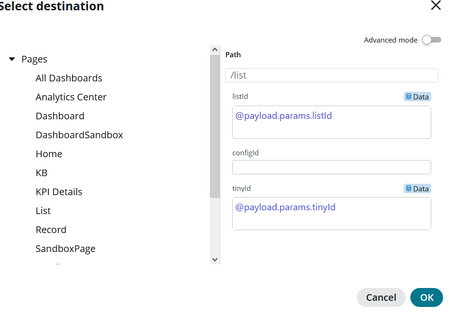

I am trying to create a graph in Ui Builder, which will take me to a list in agent workspace showcasing the 14 records that i have selected. The graph is in the picture below, and when i click on it nothing happens. I understand that I need to configure it by adding an event handler, so I have done that and added the "link to destination" but the list that opens is not filtered to show only the 14 that i have selected, instead i just opens the list containing every record in the table.

Hi @erik15 ,
How is your event handler configured?

Hi @AndersBGS thanks for getting in touch,
I have probably not configured it correctly, however, it at least directed me to the correct list.

Hi @erik15 ,
I think it's due to you have made an event handler for list and not simple-list. Below is my configuration where name is parsed to the list that opens from a single score widget:

Hi @AndersBGS ,
The simple list does indeed open a filtered list, but in a new tab. Do you know if it's possible to open the "actual" List but filtered the same way as the simple-list?
