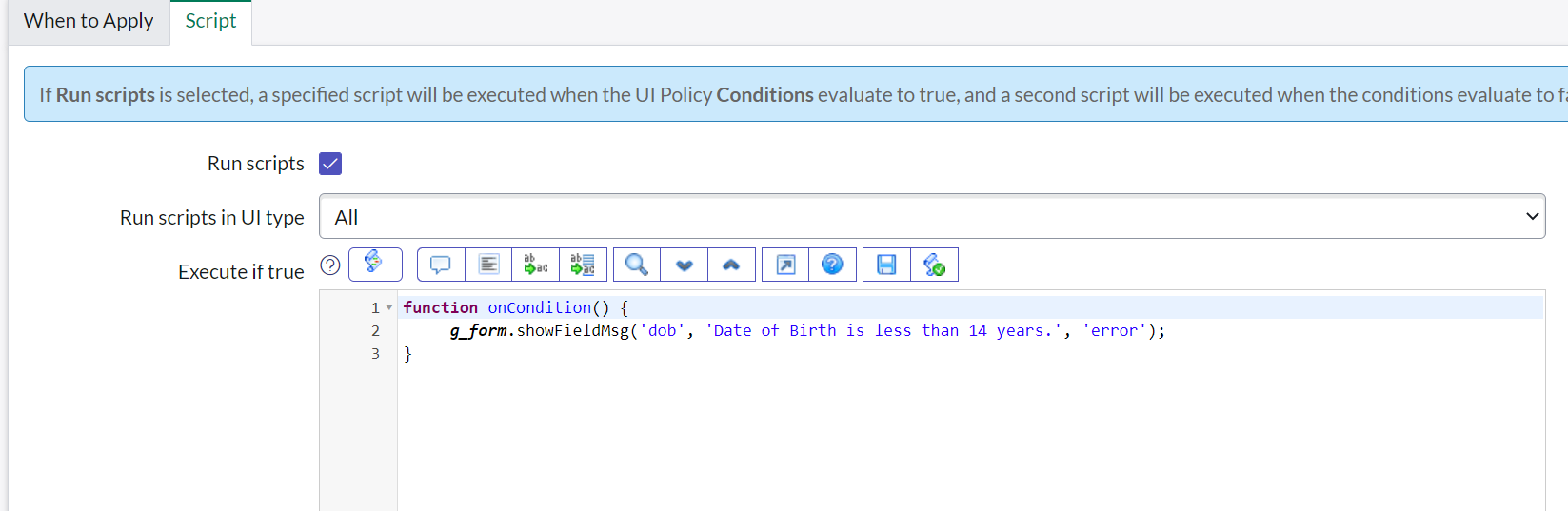

I want to validate date of birth and set a error message if the date of birth is less than 14 years of age.  So if the date of birth is less than 14 years of age then there will be an error message. I have done this from my side but it still not working. I have added the error message but I think there is something wrong with the condition. Need helpfind_real_file.png

Hi Shubham,
Where are you testing this? Is this on catalog item or on the ritm/task? if you are testing on ritm/task, then seelct the "Applies on target record" chckbox also in your catalog script and check.
Couod you also check if you have placed the error rightlyas the condition looks fine. hope you are using the right field name there.
