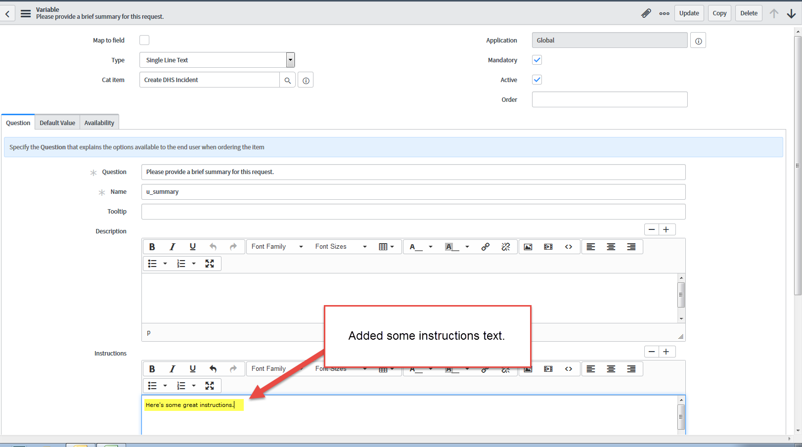

We've ran into an interesting predicament. When we create variables that have instructions, the instructions show up on the new Service Portal but they don't show up on the internal view of the catalog. Has anyone else ran into this issue and/or have a solution? Is this a bug?
See below:
Adding the instructions.
Portal View
Internal View
