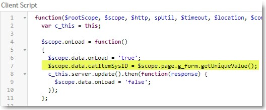

The only way that I've found do what you're trying to do is by doing this:
However, this is not the way I want to go about it.  I need to grab that sys_id before any of the HTML Template code gets rendered.
