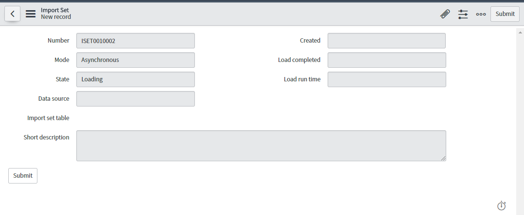

However I am stuck in below step.
Create an import set
- Enter sys_import_set.do in text filter box
- Set mode to Asynchronous
- Keep State at Loading
- Set table to import set table created in step one
- Give description if needed
Whenever I am entering sys_import_set.do in filter box; below window is getting appeared.
Since everything in read only, I am not able to change state as well as select Import set table.
Could you please help.
Thank you.
Rishi
‎02-12-2018 05:49 AM
Hi Rishi,
Yeah, it's been a couple of years since I wrote that. ServiceNow may have made updates to that table since the post. Looking at the dictionary entries of the fields and the ACL's it looks like that currently the sys_import_set table fields are set for read only but with the proper permissions can be written to.
So, this means there are a few things that you can do.
1) Use the Scripts-Background to simply update the data for the specific fields that need updating
2) Use a server side script to make your changes
or
3) Change the setting in the dictionary entry of the field(s) to not be read only. Then you should be able to write to the fields manually.
‎02-14-2018 06:53 AM
Thanks a lot Chris for your response !
I will follow the steps as you suggested above and get back to you if required.
Thank you.
Rishi
