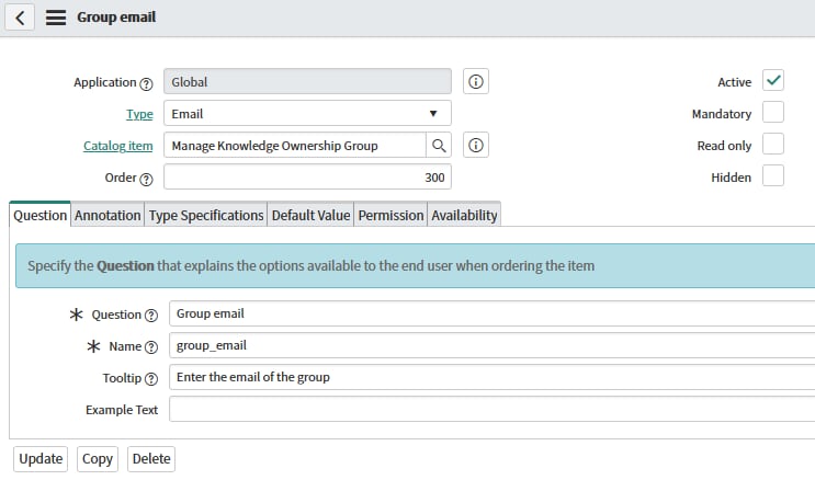

Service Catalog forms do not have a field length as can be seen from the following screenshot.
Check the following Now Support article concerning max length.
https://support.servicenow.com/kb?id=kb_article_view&sysparm_article=KB0685779
