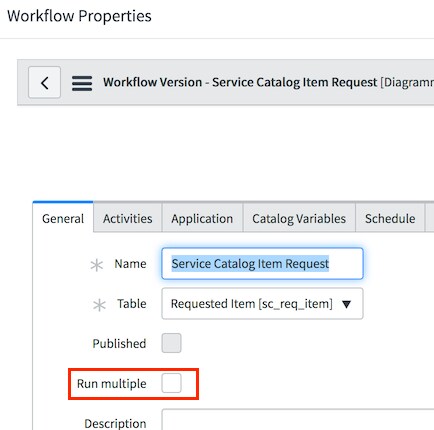

Apart from Scheduling the workflow, there is a Run Multiple field on workflow, if it's true/checked, whenever your condition matches the workflow will run.
You need to Personalize the form and add Run multiple. Then make sure it is checked otherwise the workflow will only run once.

Thanks Ajay. I tried that once before and it spawned dozens of active workflow. I may have had my condition incorrect so I will go back and try that.
