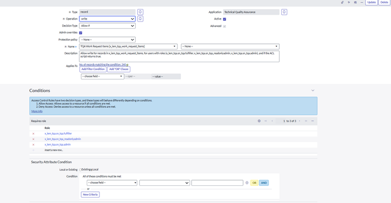

I have a custom table with multiple fields. So I need to create acls such that if the logged in user != planning assigned to then all fields will be read only for him except the "selected item" field. This ""selected item " field can only be edited if the logged in user= executor of the group. How do I create such acl. I have created a record level acl with a script and it is working fine and stopping all users other than planning assigned to to edit but the problem is it is not allowing the executor to edit. I even tried a field level acl for that but stilll not working.
MaharshiC_0-1745403311447.pngMaharshiC_1-1745403361470.pngMaharshiC_2-1745403441013.png

you don't require table.* WRITE ACL
is that user passing the table.None WRITE ACL?
If yes then your field level WRITE and table.None WRITE Should allow to edit that field
did you debug using access analyzer?
Any other client script or ui policy is blocking?
