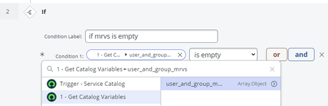

12-08-2024 04:37 AM
So beyond the if statement I showcased that determines if its empty, what are you having trouble with?

12-08-2024 04:06 AM
What part are you having trouble with? Evaluating if the MRVS is empty? Or executing the subflow?
CHECK IF MRVS IS EMPTY
Simple IF logic should suffice
RUN A SUBFLOW
Its unclear what you're doing here. Are you triggering a subflow if there is NO MRVS value? If so just define the subflow and plug it in here. Are you looping through the MRVS records and running a subflow for each? If so you need to define each of the MRVS variables as inputs for the subflow and map them appropriately.
