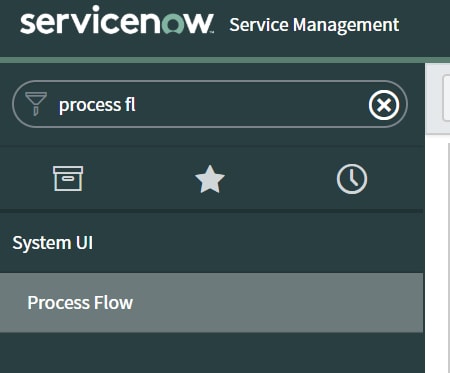

Sachin
Thanks again Sachin,
The process has been added. When I click cancel it brings state "12" instead of cancel. (Cancel state order is 12 in the process flow)
