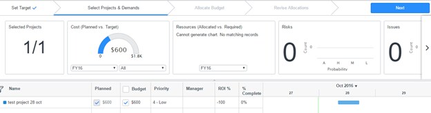

I did create a project with cost plan (600 - which got rolled up to estimated cost). Also created a portfolio and related this project to that portfolio.
On the portfolio workbench, i created a portfolio target of 1800 (900 - opex and 900 - capex).
In the second stage, i selected the project as shown below
