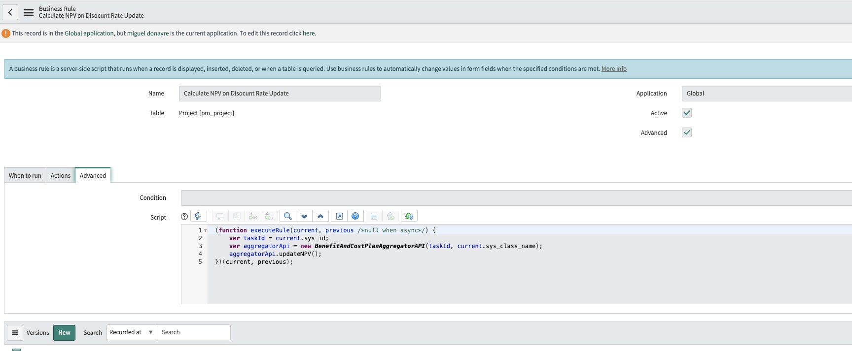

Net present value: Net present value (NPV) is calculated from the estimated cost per year, the planned benefit per year, and the discount rate for the project.
The business rules that update those fields are on the Cost Break Down table and it is called - IRR and NPV on fiscal period update. The Script Includes that does all the calculations is called - BenefitAndCostPlanAggregatorAPI
