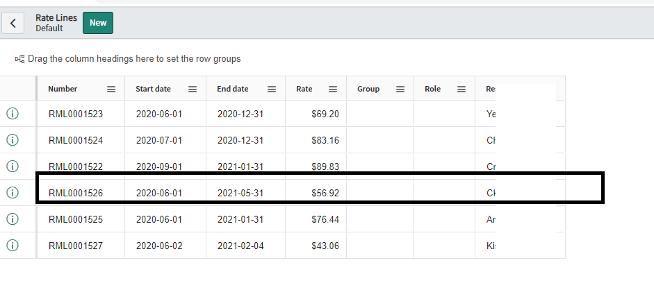

Some one help me how to take Expense Line amount from Labor Rates.
i am using OOB script, as per Labor rate card  my Hourly_rate is 58.2$, but here is taking 100$ as default. How to Fix this.
1.we are maintaining all Users of Rate Lines under Default RateModel Only
2.we are NOT selecting any Rate Model on project level , it is always be empty in all projects, so system has to take always Default RateModel.
for that we updated RMRate (Script Include), as per this, if RateModel field is empty in Project , it will consider Default RateModel

Hi ,
Thanks for reply,
we have all this setup already.
still it is taking still Default rate(100 $ )
Attached is a guide with more details around resource rate calculations.
It is difficult to see with two small screen shots your entire setup but let me know if this helps.
Rae Ann
2.we are NOT selecting any Rate Model on project level , it is always empty in all projects, so system has to take always Default RateModel.
we have only one RateModel that is Default only
Project side:
Rate model is empty.,we did some setup at RateLines Script Include. if RateModel is empty in Project record it should consider that Default model
in Project:
 Script Include: RMRates:
  Created Resource Plan for Project:  see here still it is taking 100$ as default.
in Project:
Default Rate Models of Rate Lines : my rate line
Resource Plan :   find_real_file.png
