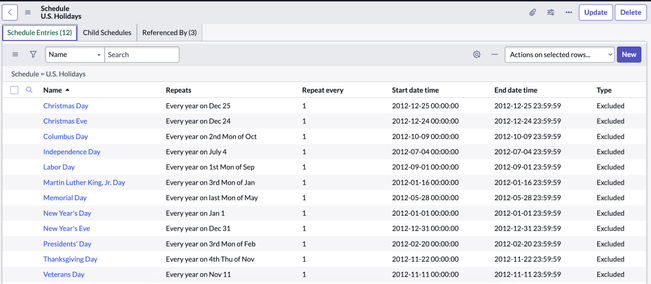

Below screenshot shows the child schedule. Notice that type for each schedule entry is 'Excluded' because these days are excluded from the capacity calculation (since these are holidays).
