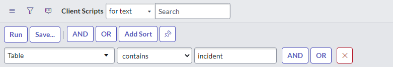

No worries @Amy V2  in order to access client scripts
1. Go to the client scripts module
2. On the client scripts list/table filter the table the client script is created for E.g if the client script is for the incident table right click on the table name and choose "Show matching".
N.B. you can also filter the table by going to the filter option by clicking the funnel icon on the top bar right below the logo.
3. Next filter the onChange client scripts just like in the second step
4. Now check by the script name
