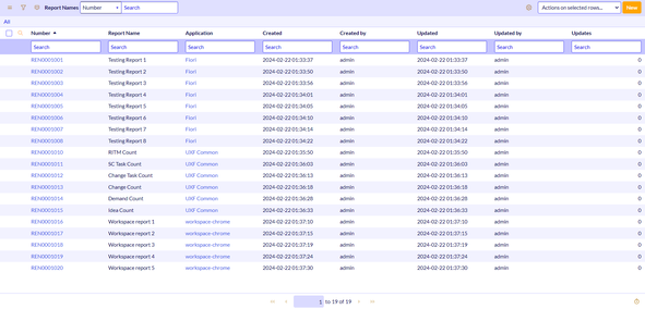

Report Name table

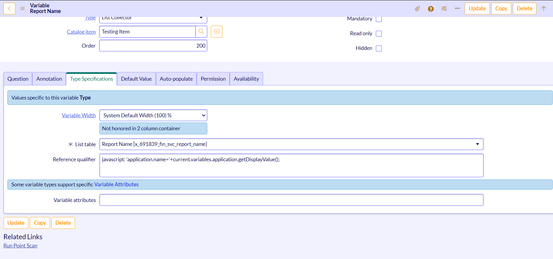

Hello @Community Alums
You can refer below SS
Mark Correct if this solves your issue and also mark 👍 Helpful if you find my response worthy based on the impact.
AniketC85155510

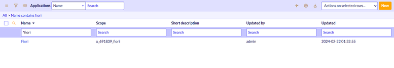

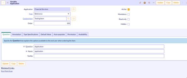

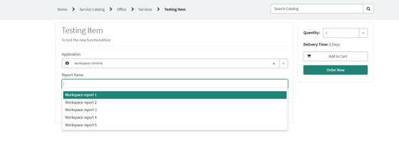

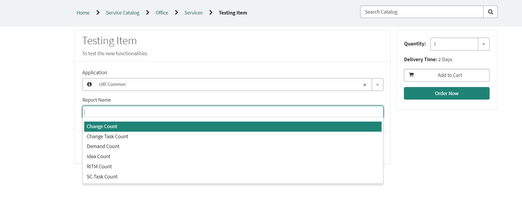

Hello @Community Alums ,
Please check out the reference qualifier below to see the available "Report Names" options based on the selected application. I created a Fiori application and a table (Report Name) as you requested. I set up variables for Application and Report Names just like yours. When I used the reference qualifier, it worked perfectly. The report names showed up based on the selected application.
Give it a try, and let me know how it goes. If you have any questions or run into any issues, feel free to ask. I'm here to help sort things out. Your feedback is important, and I'm eager to hear how it worked for you.
javascript: 'application.name='+current.variables.application.getDisplayValue();
Please Mark Correct if this solves your query and also mark 👍Helpful if you find my response worthy based on the impact.
Aniket
If it is reference qualifier-
In the advance you can mention-
javascript: 'application='+current.variables.application_variable_name.getDisplayValue();
Or
javascript: 'application.name='+current.variables.application_variable_name.getDisplayValue();
Above application is backend name of application field for the reference table
I have edited my response now you can refer.
