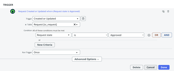

1. Trigger: I added Request State Approved to make sure all Request Items and Variables have been created before triggering the Flow.

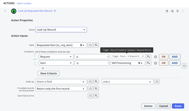

2. Look Up Requested Item Record

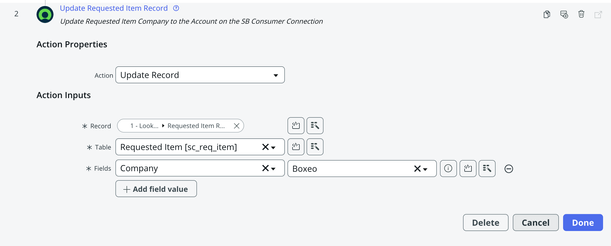

3.  Update Requested Item Record Company to the Account on the SB Consumer Connection

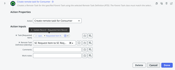

4. Create remote task for Consumer

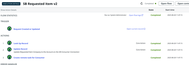

5. Execution Completed
