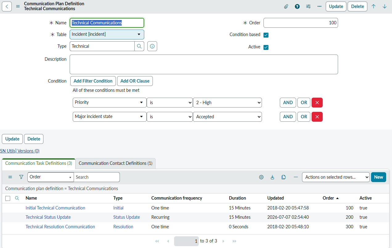

I keep getting this message when trying to complete this course:
Did you update the duration of the recurring Status update tasks for each of the Technical Communica...
I set all the technical Recurring Status updates to 15 minutes. Didn't work, so I set all the recurring status updates to 15 minutes. That didn't work. So I made sure the Service Desk user (not group) was on every Communication Contact Definition. That didn't fix it. Every communication plan has a status update that is set to 15 minutes. What am I doing wrong? I can share screenshots if needed, but I can't figure out how to resolve the issue.

07-07-2026 06:29 PM
This is just the technical comms, but after this didn't work the first time I went through an added a status update (if it was missing) and updated the duration to 15 minutes. All of them match this setup right now. All the communication contact definitions still have the Service Desk user as well.
