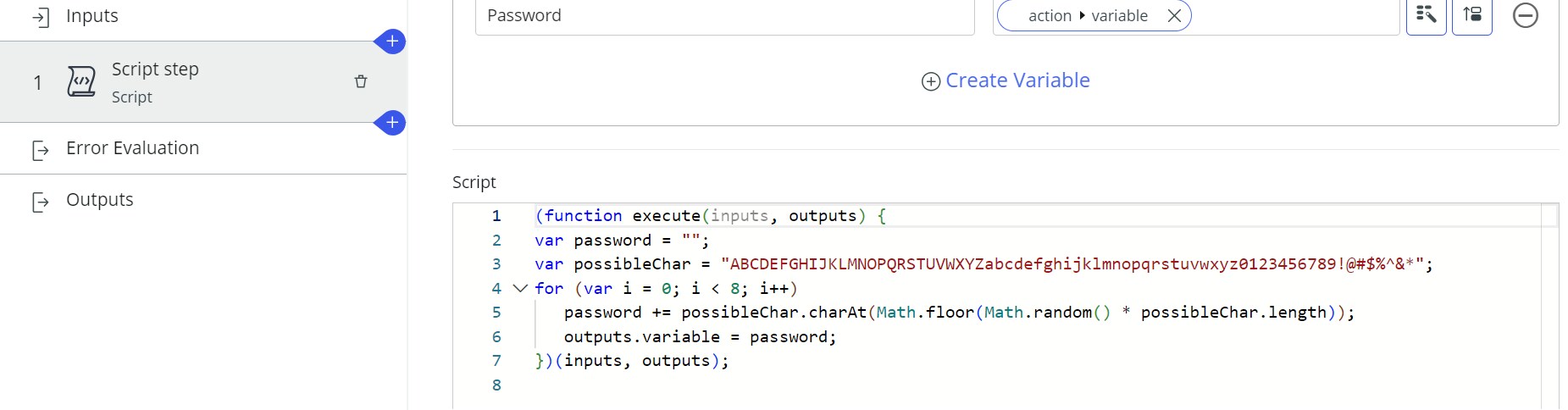

Hi Harsha,
You need to define the output first in the script step as below
and then the final output variable value will be taken from the script step output
This will give you the correct output.
