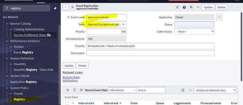

Step 1 : Create Event Registry
Name - approval.reminder

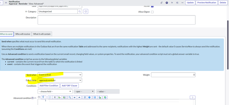

Step 2 : Create Notification
When to Send : Event is fired
Event Name - approval.reminder

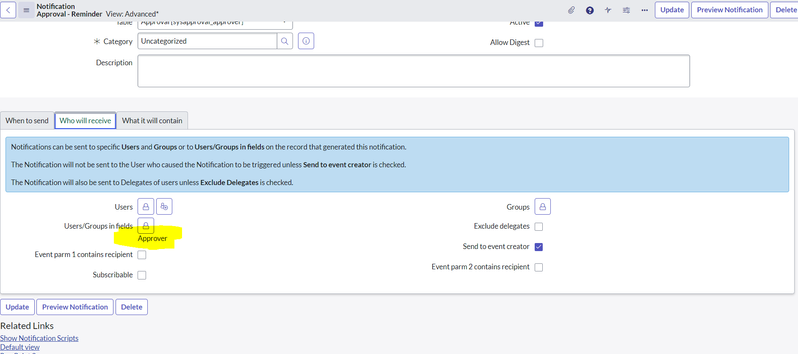

Who will Receive : Approver

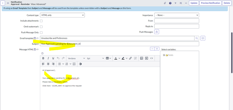

What it will contain : Your mail body

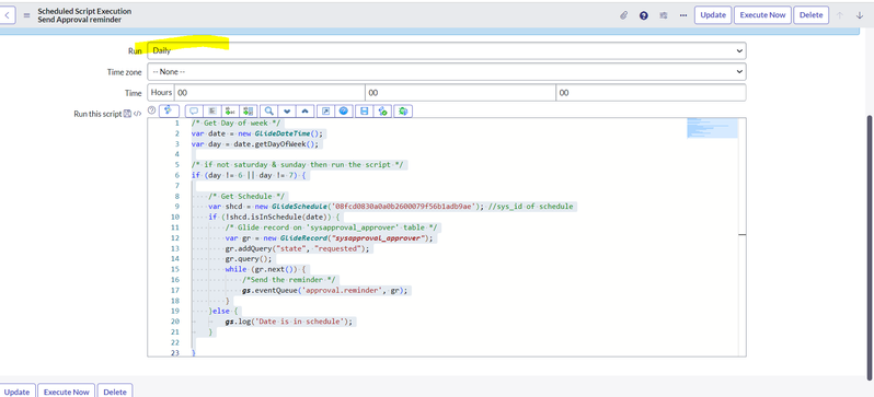

Step 3 : Write scheduled job
/* Get Day of week */
var date = new GlideDateTime();
var day = date.getDayOfWeek();
/* if not saturday & sunday then run the script */
if (day != 6 || day != 7) {
    /* Get Schedule */
    var shcd = new GlideSchedule('08fcd0830a0a0b2600079f56b1adb9ae'); //sys_id of schedule
    /*Check if date is not in schedule*/
    if (!shcd.isInSchedule(date)) {
        /* Glide record on 'sysapproval_approver' table */
        var gr = new GlideRecord("sysapproval_approver");
        gr.addQuery("state", "requested");
        gr.query();
        while (gr.next()) {
            /*Send the reminder */
            gs.eventQueue('approval.reminder', gr);
    }else {
		gs.log('Date is in schedule');
Hope this helps...!!!
