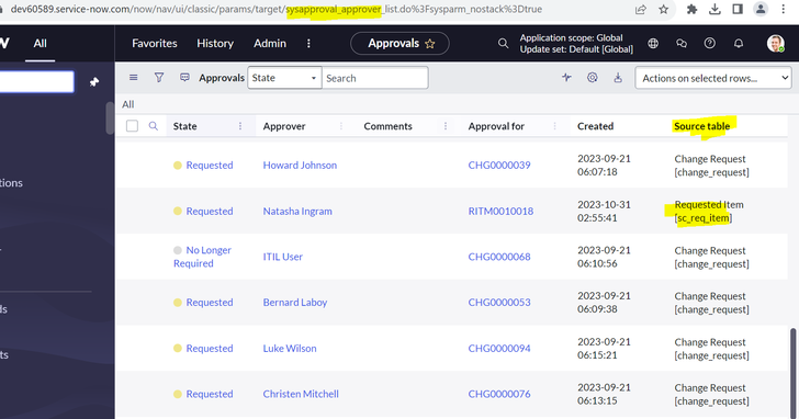

Hi @aniellacerna
On sysapproval_approver table we have column as 'Source Table'
You can add a query in your scheduled job for Source table = Requested Item (sc_req_item)
gr.addEncodedQuery('state=requested^source_table=sc_req_item'); //customized query
